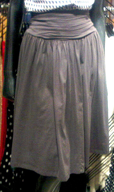

Thank you for your response and I do apologise for not clarifying which dart I was referring to.  I am new to the forum & still finding my feet.  I have really enjoy your lessons so far, they keep me up because I usually want to learn the next stage.  I was referring to the closure of the waistline dart in my earlier mail. Please see attached in an email of the skirt I wish to replicate to the support email address..  It is gathered and sort of flared & hence has no dart.

Thanks so much for the kind words. Since we dont have a picture from the back, We can assume that the back is the same style as the front.
You can place the zipper on the side seam, this way the back will look nicer. The ruching is sewn on a flat yoke, this yoke can have all the waist and center back darts to give it the shape of the body better. The ruching has no darts and is cut on a bias, then it is formed and sewn on  the yoke.
