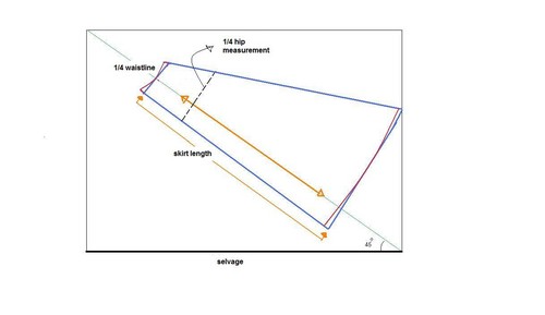

Thanks for the tips. I'm glad I found your website. I attached a first draft of the skirt flared panel. Does it look okay? I also have a few more questions.
Do I need to cut four panels of lining on the bias as well?
Is it a good idea to cut the lining a little shorter than the shell so it doesn't show when I wear it.
Is the lining qoing to be attached to the shell by the waistline and zipper only?
I will use rolled hem technique on the shell and lining.

Re: Pattern for Panel Skirt
Dear Enas,
Thanks for the kind words. If you are using a ready made pattern and the grain line placement is as you are presenting it here, you can move your pattern to the top left and down, this way your grain line will be parallel to the bias line on the fabric.
Yes, you need to cut four panels on bias for the lining as well.
Yes, cut the lining shorter so that the finished skirt has the lining about 2 to 3 cm shorter than the shell.
Yes, only attach the lining to the waistline and around the zipper.
The rolled hem technique works well on light fabrics, so if your shell is also light you can roll its hem.
